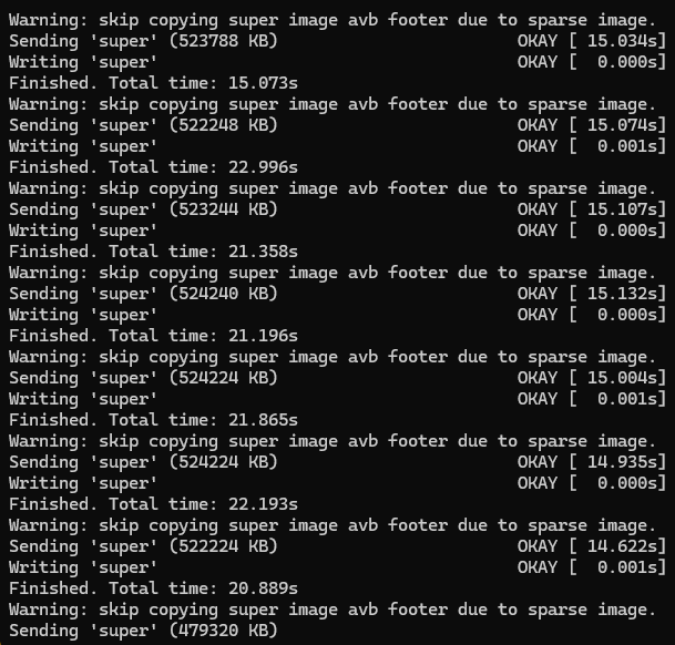

Xiaomi Redmi Note 12 Pro 4G (sweet_k6a) I have tried updating the MIUI to HyperOS 1.0, It is now bootlooped...
InFGG
24 Dec 2024
2
But at the end It just started telling me It can't import some sort of file (i only remember it saying i believe around 51000 kb and .img i think). After this process of trying to import a file and failing over and over i thought it would be a great idea to stop this process and run it with clearing data. Guess what, It did not help. So now my phone is in a bootloop. I can however hold the volume up/down for the boot helper/fastboot and they work fine, except fastboot
Nevermind it actually does respond, bbut it tries
> Sending 'super' (522248 KB)" OKAY [15s~]
and repeats this action after it ends
> Writing 'super' OKAY [0.000s]
Then instead of going on it gives a warning
> Warning: skip copying super image avb footer due to sparse image.
Please help.
Update:
I clicked again the windows intsall and fomat and now it says
> Waiting for device...
> Compatible devices: sweet
> Your device: unknown
> Press any key to end the cmd thing it displays
nevermind I just fixed it, to be honest i have no idea how, but I did find a flash everything thing and It might have been the thing i needed (this was my over 20th try updating)

Usually, when I tried downloading, the console just paused at some point. All I did is Press the On button and volume down for it to restart and the console to reconnect to my phone. In the end I DID ITT
