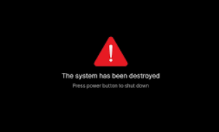

My K50 Ultra was working perfectly until recently. I was running the Diting ROM, but I started getting messages saying I couldn't make payments or work with Uber because the bootloader was unlocked.
To try and fix this, I decided to lock the bootloader using CMD (command prompt). Unfortunately, right after doing this, my phone displayed a "system destroyed" message (as shown in the attached image).
Now, I can't flash a new ROM because the bootloader is locked. Since I'm in Brazil, I tried to unlock it using XiaomiFlash, but the software told me my phone is of Chinese origin and my Mi account is Brazilian, which is preventing the unlock.
Does anyone have a solution for this, please?
Reactions: Eclipse1991
There is no solution. Your phone is gone. Should have never locked the bootloader while an unofficial ROM is installed.
That unless you can find someone who can unlock your phone and flash a stock ROM for a payment (black market solution).
Good luck.
