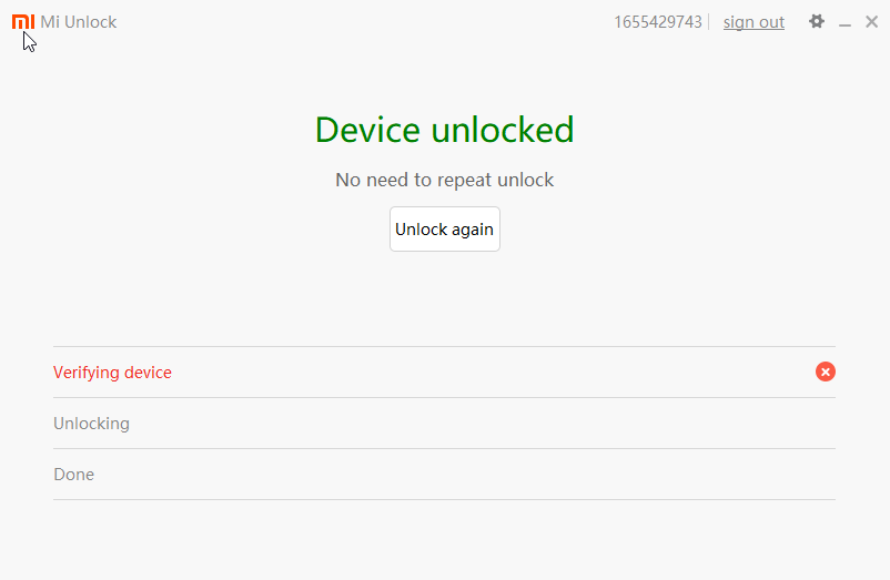

Propably my bootloader is locked again :/
What can i do now? Any ideas?
@edit
Mi Unlock shows device unlocked. So i havent any idea now.
