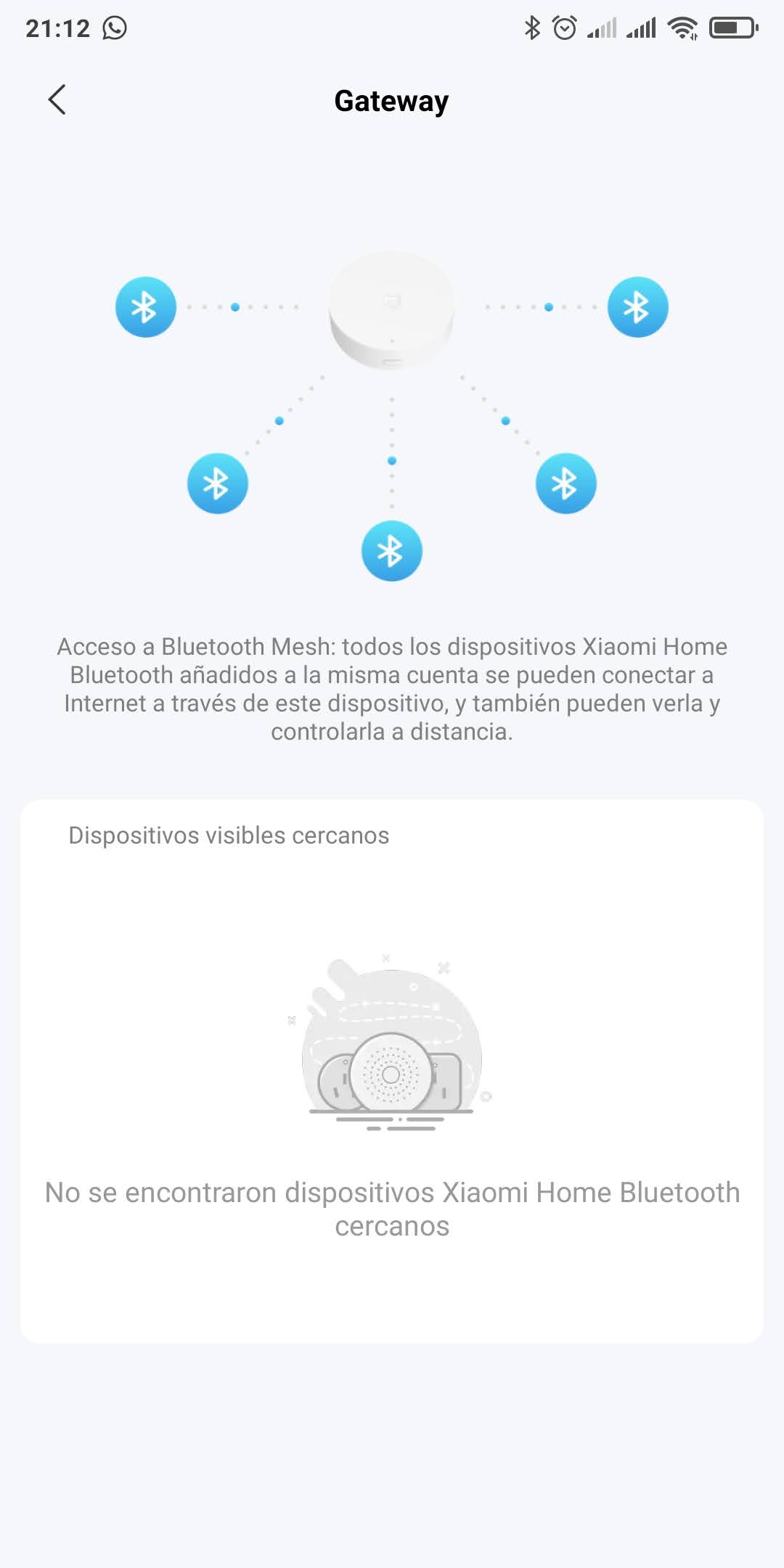

Hi, I have the smae problem. I received my new Xiaomi gateway 3 last wednesday 11. My 4 units of "mi temperature and hygrometer monitor 2" received four weeks ago. On section Bluetooth mesh doesnt shows those 4 monitors.
I just tried to put on China region, but nothing new.
What can I do? What can we do! Xiaomi, please, fix it! :(
Best regards.

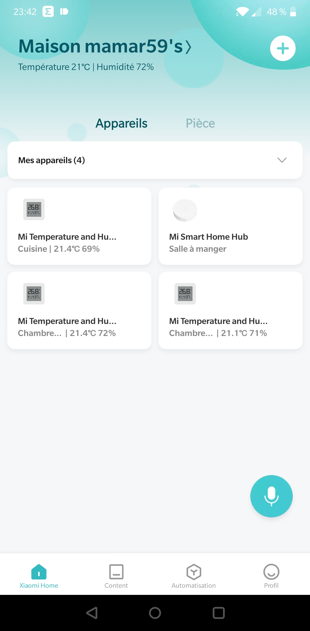

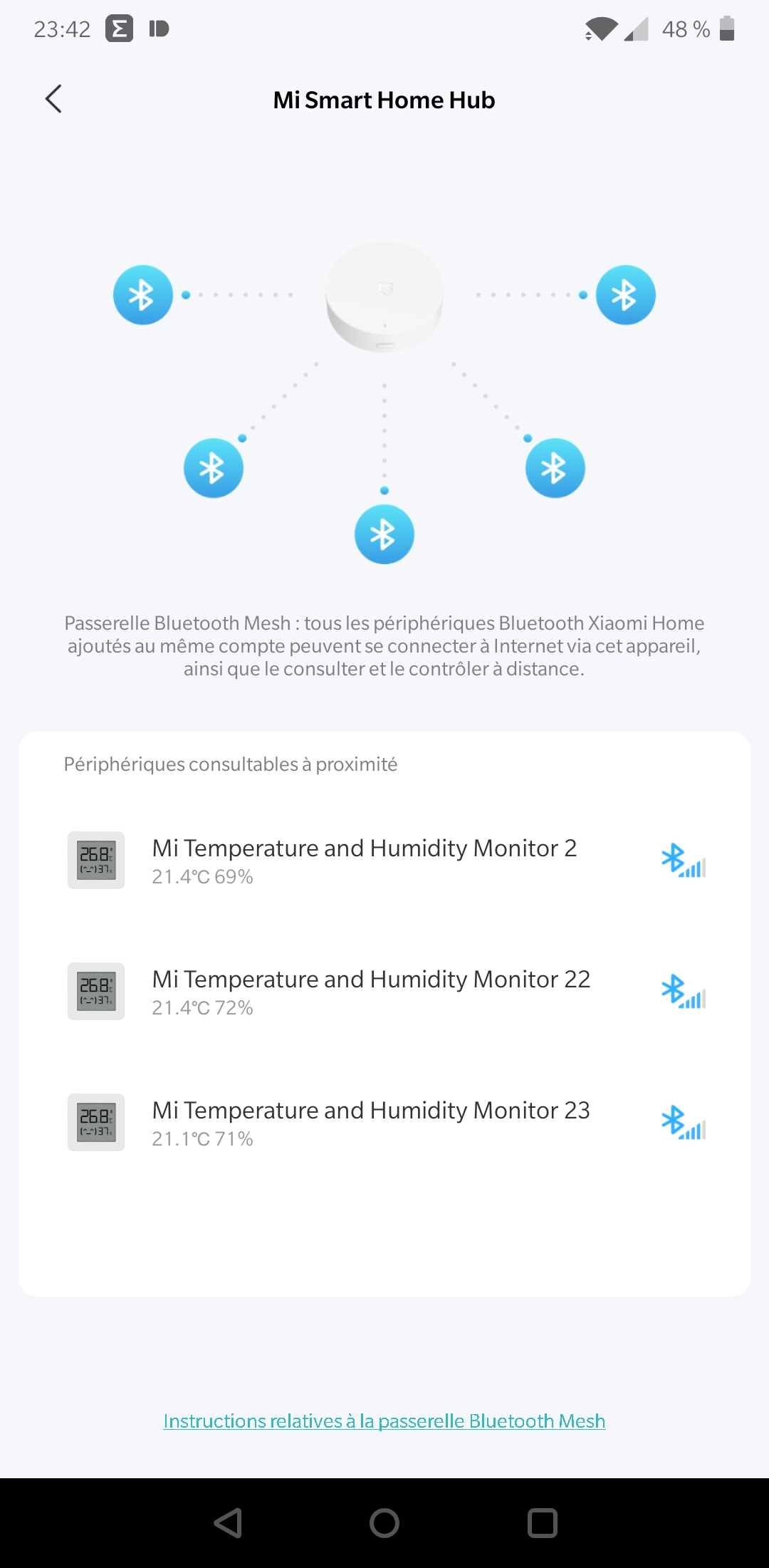

HI I am from France, I have 1 Mi Smart Gateway Hub and 4 Mi Temperature and Humidity Monitor 2 I have just succeeded in all connected seemingly after having searched well and all trying, to get there you have to put maindeland CHINA not the choice and then you must appear several times your sensor so that it appears in the hub, I believe that xiaomi has problems with our European version
Thats not a option for me, I have some devices that only works on European Server and need them connected with the sensores.

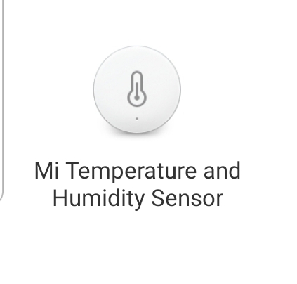

Bom dia,
Esses sensores em principio não deveriam aparecer nos child devices, pelo menos para já.
Mas deveriam ser detectados no bluetooth mesh gateway, e ai é que está atualmente o problema. Simplesmente não é detectado de forma nenhuma.
