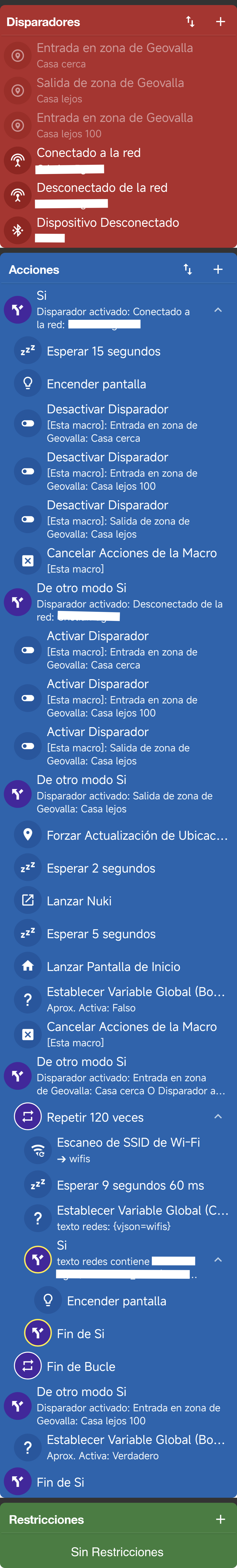

Macro Triggers
- Geofence (Enter): [Geofence_Close] (e.g., 50m radius)
- Geofence (Exit): [Geofence_Far] (e.g., 150m radius)
- Geofence (Enter): [Geofence_Intermediate] (e.g., 100m radius inner)
- Wifi Connected: [Your_Home_SSID]
- Wifi Disconnected: [Your_Home_SSID]
- Bluetooth Disconnected: [Your_Car_Bluetooth_Name]
Actions Structure and Logic
If: Trigger fired: Wifi Connected: [Your_Home_SSID]Wait 15 seconds
Turn Screen On
Disable Trigger [This macro]: Geofence Enter: [Geofence_Close]
Disable Trigger [This macro]: Geofence Enter: [Geofence_Intermediate]
Disable Trigger [This macro]: Geofence Exit: [Geofence_Far]
Cancel Macro Actions [This macro]
Else If: Trigger fired: Wifi Disconnected: [Your_Home_SSID]
Enable Trigger [This macro]: Geofence Enter: [Geofence_Close]
Enable Trigger [This macro]: Geofence Enter: [Geofence_Intermediate]
Enable Trigger [This macro]: Geofence Exit: [Geofence_Far]
Else If: Trigger fired: Geofence Exit: [Geofence_Far]
Force Location Update
Wait 2 seconds
Launch Application: Nuki (io.nuki)
Wait 5 seconds
Launch Home Screen
Set Variable: Aprox. Activa = False
Else If: Trigger fired: Geofence Enter: [Geofence_Close] OR Bluetooth Disconnected: [Your_Car_Bluetooth_Name] [AND Aprox. Activa = True]
Repeat 120 times
Wifi SSID Scan ➔ wifis
Wait 9 seconds 60 ms
Set Variable: texto redes = {vjson=wifis}
If: texto redes contains [Your_Home_SSID]|[Other...] (Regex Enabled)
Turn Screen On
End If
End Loop
Else If: Trigger fired: Geofence Enter: [Geofence_Intermediate]
Set Variable: Aprox. Activa = Verdadero
End If
