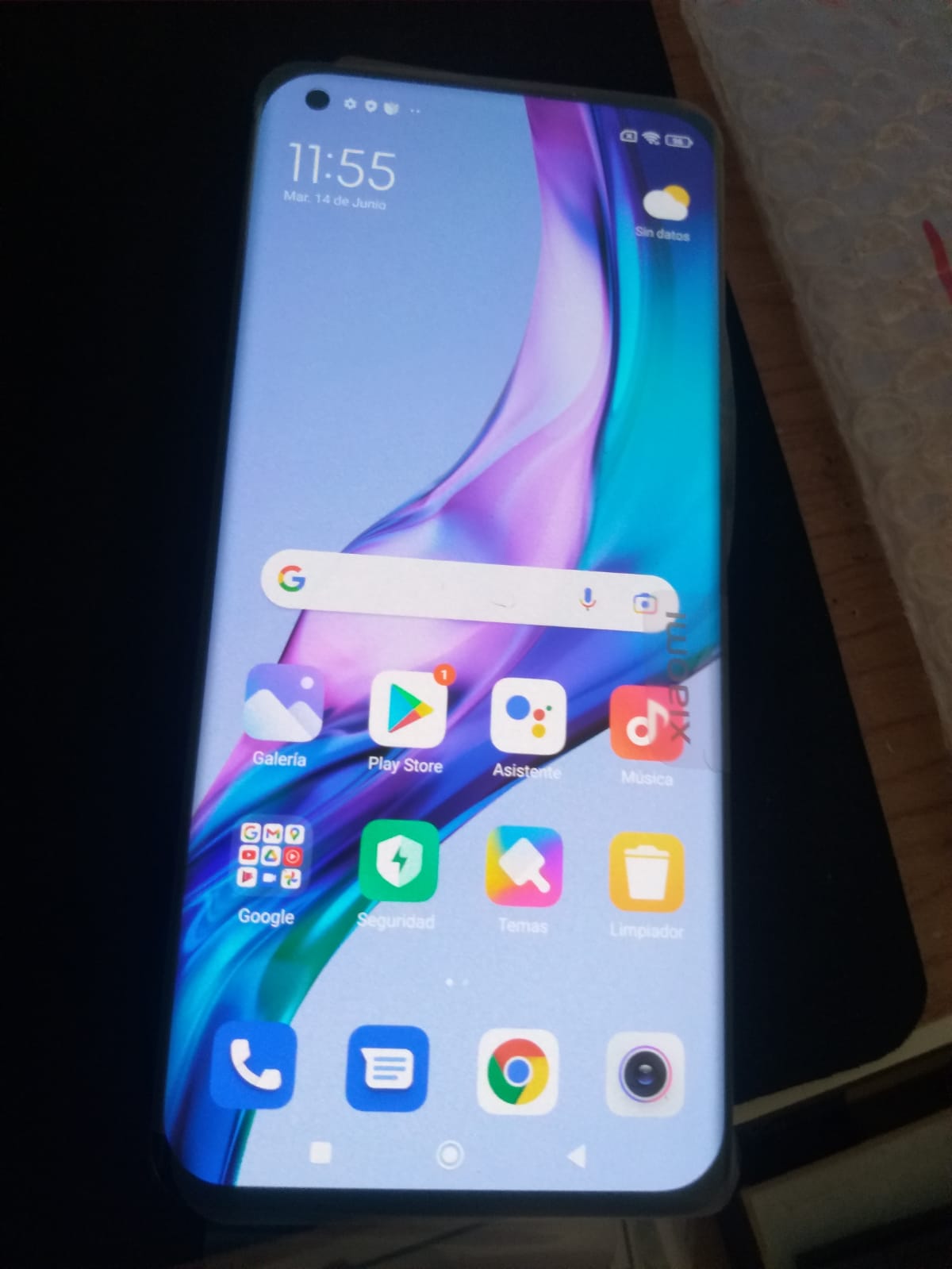

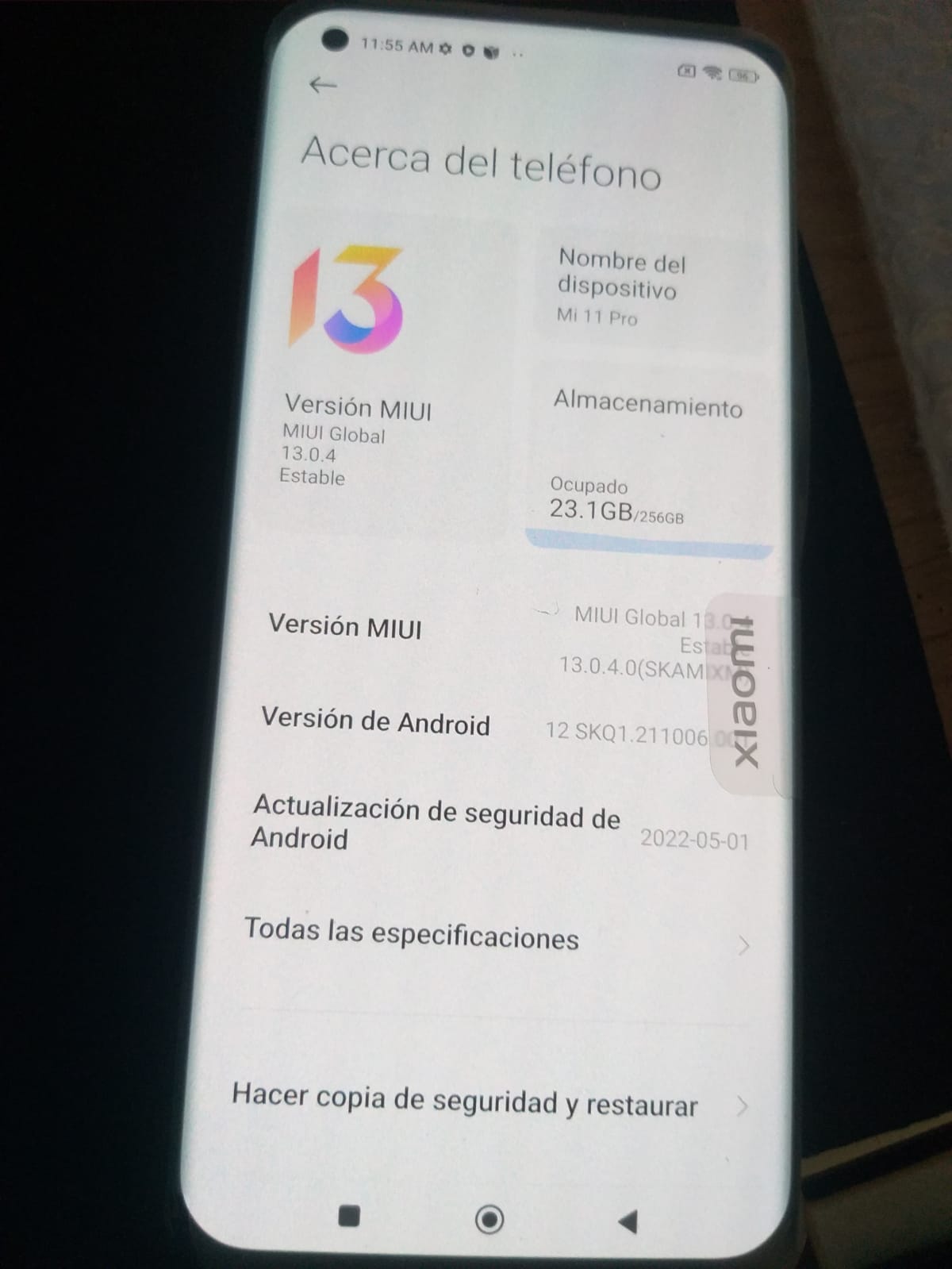

I managed to install the Global rom of Mi 11 pro Mars
1) Check the ARB and in both roms, the current one and the one you wanted to install in both the version was: 1
2) Unlock bootloader
3) Install with Mi flash without problems
Totally successful job!
